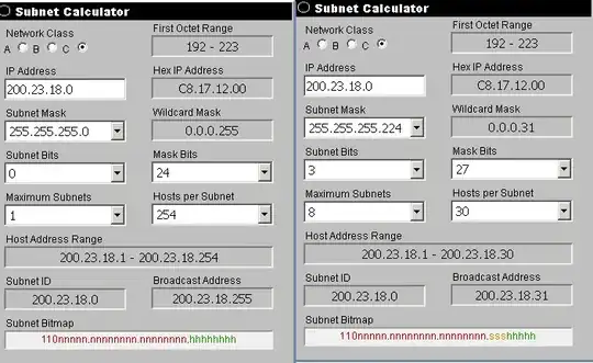

Is it possible for two networks to have the same network IP address if two different masks are used?
Take for instance the addresses 200.23.18.0/24 and 200.23.18.0/27. I'm thinking that this might be problematic. Suppose a router that connects the two networks recieves a datagram whose destiny is, for example, 200.23.18.3... How can it know where to send it? What path would the datagram follow? AFAIK, the host could be located in any of the two networks described above, so I don't see a solution if this is allowed to happen.

Usually a router will pick the destination with the highest bit matching precedence, in other words the route with the longest mask.

    Let us ignore the first 3 bytes as they are constants and covered by both masks. Mask 24 has then nothing more to match (24 bits = all 3 first bytes), whereas mask 27 has still 3 bits to match. IP address 200.23.18.3, and for our discussion in fact its latest byte with value 3 matches the 200.23.18.0/27 mask as in both cases, vales 0 and 3 of the last byte, share their first 3 bits (000). So IP 200.23.18.3 matches 200.23.18.3/27 "more" than 200.23.18.3/24. – Patrick Mevzek Jan 30 '18 at 15:32
