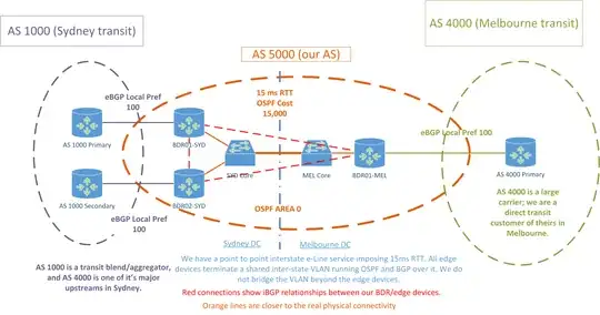

We are a managed service provider running a small sized network in a single datacentre in Sydney. We've recently deployed a new POP inter-state in Melbourne (both are on the east coast of Australia), and for the first time I am having to face real-world challenges in terms of traffic engineering. My hope is that I can get some guidance here on how to get some level of control over my iBGP paths.
I will likely be posting a few inter-related questions, but in this case I am specifically concerned about internal traffic engineering. I'm finding it surprisingly difficult to figure out how to get iBGP to make optimal routing decisions.
The main goal to me is that need to find a way of giving iBGP some concept of a boundary and a distance per POP. So I can distinguish between a POP that is in the same city, vs one that is inter-state, vs one that is east vs west coast. Then optimise inbound/outbound routing based on this.
I know that there will be a lot of case-by-case scenarios, but I'm hoping I can develop an iBGP routing strategy that works maybe 80% of the time and the rest I would have to deal with special edge cases in the config.

Essentially, I want to be able to achieve optimal routing between POPs as we deploy them. But right now I am not able to achieve any level of control over how iBGP is choosing it's paths.
My current design
  • I currently have 2x ASR1Ks acting as edge routers with full tables in Sydney, and one in Melbourne.
  • Both POPs use different transit providers.
  • We have a point to point circuit between the two POPs which is terminated on both sides by the edge devices on dot1q sub-interfaces.
  • We run OSPF over this link between all the edge devices, and the cost of the link is increased so this is the lowest preference OSPF path.
  • We have a single OSPF area 0 across both POPs.
  • The edge devices are more of a converged core/edge - our core switches don't do much L3 as they can't handle a full table.
  • In each POP the ASR1Ks act as route-reflectors for the other BGP devices in that POP - firewalls, core switches, LNSes and so on.
    • Each has their own cluster-ID - not per POP. Looking a changing this to per-POP.
  • Each ASR1K originates a default route to route-reflector clients over BGP.
  • All the ASR1Ks are in an iBGP mesh.
  • All transits have the same local pref at all sites.
Example of sub-optimal routing
  • If I have my Melbourne and Sydney transits all online, outbound routing works fine. Sydney traffic exits via Sydney and Melbourne exits via Melbourne.
  • The problem is that just by admin-disabling my primary Sydney transit, my Melbourne transit is automatically now preferred. Instead of my secondary Sydney transit via the BDR02 router in Sydney.
  • So I end up with a scenario often where the traffic will then bounce over to Melbourne over our backhaul, exit in Melbourne, then route back to Sydney. The path that was incurring < 1ms is now about 30 ms.

I will add more details tomorrow. For now, here's a diagram that depicts our current setup.
Interstate datacentre diagram
