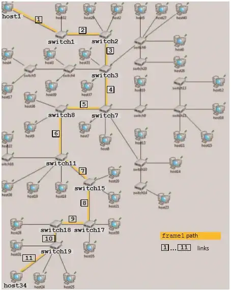

In the LAN depicted in the picture below, am I correct in saying that devices do not have IP addresses? There is no router and also only Ethernet frames (with source and destination mac address would be transmitted) and not IP packets. Is that a correct assumption?
Network image

No, that's not correct. You don't need a router for two hosts to communicate using IP as long as they're in the same network.

NO. IP packets are encapsulated inside Ethernet frames. It's not one or the other.

Ethernet communication is local only (segment) - across all switches (or repeaters) within a single VLAN (when other VLANs exist).
IP packets are transported as payload (layer 3) inside Ethernet frames (layer 2) or any other suitable link layer.
Due to the local-only restriction the IP communication in this network is confined to the local subnet. Multiple subnets can co-exist in a single L2 segment but they can't communicate with each other. Communication across subnets requires routers.

No, you can't deduce that from just the picture.
You could have hosts without IP addresses, but you could also have IP addresses. You don't need a router to assign IP addresses. You could:
  • have a host running a DHCP (or even BOOTP) server providing IP addresses to the other hosts
  • have hosts with manually configured IP addresses
  • have hosts using auto-configuration IP addresses (IP addresses in the 169.254/16 network)
As for traffic, provided we are indeed talking about Ethernet switches and interfaces, you can have Ethernet frames running through the network, and these Ethernet frames could contain anything, including IP packets. Without a router connected to the outside world, they would not be able to reach other networks (or the Internet at large), but the hosts could speak IP between them provided they somehow got IP addresses as described above.

Yes and no. At the data-link layer (Ethernet in this case), there is no concept of an "IP address": the only address that exists is the MAC address. Frames that are sent can be marked as containing IP packets (EtherType 0x0800/0x86DD), but it's up to higher-level layers to decide what to do with the data.
So if you're looking at this solely at the point of view of the Ethernet interface, you would be correct. However, looking at this from the point of the device using the interface, you would be incorrect: it would see the network from the TCP/IP or UDP/IP layer and would usually be completely indifferent to what exists beneath that.
A wrinkle that can occur is if you start using VPN tunnels. If you set up a VPN in bridge mode (let's say between switches 2 and 3), you now have a layer 2 frame encapsuled inside a higher-level packet!

What you say is more or less correct: None of your switches have IP adresses. But your hosts do have a IP and the ethernet frames that pass the switches contain the IP's of host1 and host34. Your switches just don't care about those IP's.

Just for fun: YES.
Can Ethernet frames only be transmitted in a LAN?
Yes, Ethernet frames in a strict sense are only transmitted in a LAN. In a WAN, you will have other formats.
Yes. The yellow line as many switches, which, as related to the packages between the two hosts, do not have IP addresses.
Modern switches can obviously have IP address of their own for their own configuration (i.e., if they offer a management web GUI). But simple household switches, even if they are rather intelligent (i.e. if they do not broadcast any and all ethernet packages on all ports, like they did in the stone age of networking), need to have no IP address at all.
Remark regarding comments: this is equivalent to saying that all the switches between those hosts are part of one subnet (i.e., one IP netmask). This is, admittedly, to some extent an assumption, as these days there can be very complicated switches, and some people may even call routers switches. But still; per default I would assume that a chart labeled with switches contains switches. They may (in fact, they most certainly will) look at the IP address to make the decision on which port to send a package. But they do not introduce new IP addresses as part of the path the packet takes.
