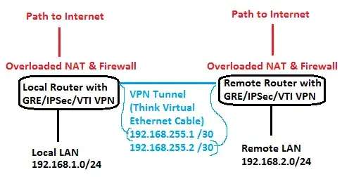

  • Site-to-Site - GRE/IPSec/DMVPN/VTI Based VPN Technology:
    You can have a Local and Remote Router each with 2 physical Routed Ports.
    -(One Physical Port goes to the Internet Modem)
    -(One Physical Port points to the Core LAN Switch)
    -A virtualTunnel Interface is created on each router (one that supports multicast/routing protocols) VTI Diagram
    DHCP client 192.168.1.100 on Local LAN keeps their same IP, doesn't need any special software, configuration, or Virtual IP Address Pools, they just ping 192.168.2.100 on the Remote LAN. And their Local Router has a route to the remote LAN in it's routing table, so it forwards the traffic over the tunnel. (It does this in a way that bypasses NAT and the firewall effect of NAT.)
    (It works as if the Router's 2 WAN ports were connected by a single Ethernet Cable.)
    Pro: No configure needed by clients.
    Con: PC on Local LAN can only ping PC on remote LAN when they're connected to the Local Router, if they connect to a different network like the hotspot on their phone, they won't be able to ping the remote LAN. (because their phone's gateway doesn't have a route to that remote LAN.)
