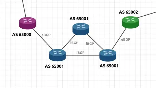

Just wanted to expand a little bit...
illustration
BGP heavily relies on AS numbers when it comes to loop prevention. If there are multiple routers within the AS, they by definition are sharing the same ASN, making it impossible to rely upon ASN to prevent loops between them. That's why something else should be designed -- routes received from routers with the same ASN are simply not propagated back to routers of that AS. That's where full mesh becomes a requirement so that BGP tables on all iBGP participants stay consistent.
http://network.jecool.net/bgp-loop-prevention/
In BGP there are two loop prevention mechanism:
  • for EBGP there is AS-Path attribute which states that router will drop BGP advertisement when it sees it own AS number in AS path
    attribute
  • for IBGP there is split horizon rule which states that update sent by one IBGP neighbor should be not send to another IBGP
    neighbor
Quite an important piece of already mentioned RFC 4271: https://www.rfc-editor.org/rfc/rfc4271#section-5.1.2.
