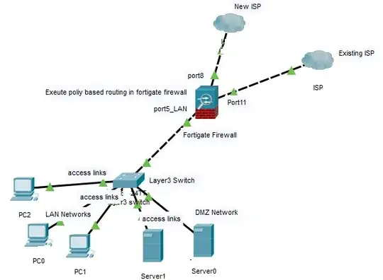

Yes! you can make it possibly as per your requirement I understand that your want web -browsing traffic ie is tcp-80 & tcp-443 outbound traffic wants to flow from secondary internet link . And primary internet link will use remaining traffic other thàn web -traffic to configure this requirement .
  1. policy - routing will have priority then default route as we know..
Create two outbound security policies for internet access for both isps
Assume
Port11 -first internet link
Port8 - second internet link
Port5 -Lan interface
Create policy for secondary internet link
Source interface : Lan Destination interface :port8 Source address : Any Destination :address :any Service : http &https Action : allowed Security profiles : on
Create policy for primary link
Source interface :Lan Destination interface : port 11 Source address :any Destination address :any Services : any Action allowed Security profiles :on
Keep secondary internet link policy on top Now create policy based route
Às source as : Lan subnet Destination :any Interface : Port 8 Action :allow
And then configure default route as
Ip route 0.0.0.0 0.0.0.0 pointing towards first isp gateway ip route 0.0.0.0 0.0.0.0 pointing towards second isp gateway
Let's see now traffic flow
Any user àccessing internet from LAN will first check policy based routing if ip matches packet will be send to policy of secondary link as per policy if traffic is 80 and 443 is allowed ànd other traffic is second on second policy that is first internet link policy .. in this you can configure your requirement all 80 and 443 traffic will flow from secondary link and remaining traffic will flow from first internet link unwanted traffic will be denied in implicitly deny policy at bottom... Like wise you can configure your requirement..
