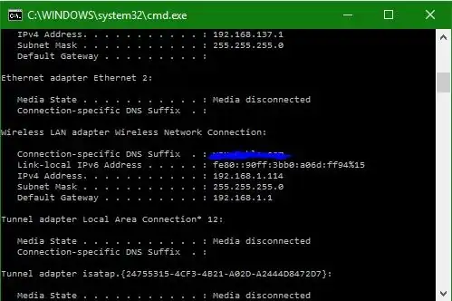

I'm trying to figure out the MAC address of my router.
This picture is of using the command ipconfig:

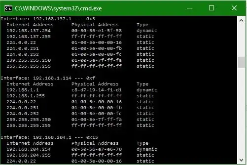

This picture is of using the arp -a command:
I see it says my IPv4 address is 192.168.1.114, so I go down to it in the arp -a command. However, there are many different MAC addresses for it. It also says the default gateway is 192.168.1.1, so my question is: Which one is my router MAC address? Help would be appreciated. Thanks!

According to your screenshot, the ARP Cache entry for 192.168.1.1 is c8d7.1914.f1d1, which is likely the MAC address of the router interface to which you are connected.
According to your output of ipconfig/all, the MAC Address of your Network Interface is 844b.f522.6f98.

  • Is that the router MAC address? – Yoshi24517 Apr 07 '17 at 04:44
    Yes. Technically, the result of an ARP response for 192.168.1.1, which is likely your router. – TDurden Apr 07 '17 at 04:46
  • Quick question: I did ipconfig /all, and under the one with the IPv4 address set to 192.168.1.114, there is an entry that says "Physical Address: 84-4B-F5-22-6F-98" Is that a router MAC address also? – Yoshi24517 Apr 07 '17 at 05:02
  • No, that is your MAC address. – TDurden Apr 07 '17 at 05:12
  • Well then which one is it? The arp -a one or the ipconfig /all one? – Yoshi24517 Apr 07 '17 at 05:26
  • By your MAC address I mean the MAC of your own Network Interface Card or Wireless Adapter. Every Ethernet Interface (wireless or Wired) has their own MAC Address (there are exceptions outside of the scope of this post). – TDurden Apr 07 '17 at 05:29

You can issue tracert 8.8.8.8 from your PC and find out the next hop IP address, that would be your next hop (gateway IP address) IP address, after that, issue command arp -a, and see that IP address mapped to which MAC address and that MAC address is the next hop (gateway).
Following is just for example.
C:\Users\>tracert 8.8.8.8
Tracing route to google-public-dns-a.google.com [8.8.8.8]
over a maximum of 30 hops:
  1     5 ms     5 ms     5 ms  192.168.1.1**
  2     5ms      5ms      5ms   10.11.12.13
  3  ^C
C:\Users\>arp -a
Interface: 192.168.1.1 --- 0xb
  Internet Address      Physical Address      Type
  192.168.1.1            c8d7.1914.f1d1     dynamic
Hope this answer helps you.
