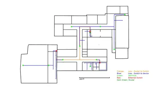

EDIT: I was asked to provide the layout of the building: Building Layout
The red points are all available to be used for networking. Unfortunately, from each individual point, the opposite end of the building is greater than 300ft away. The walls are also cinder block up to the ceiling, so running through walls is not an option. The picture shows what I had planned to wire.

The switches I am planning to use are the Summit X450E-24P. These do have SFP connections, however, they are still restricted to 1Gbs. Any suggestions on utilizing fiber to connect them? I could certainly aggregate a few lines, then trunk over to the other switches, but that could be done just as easily with cat6a.

  • Thanks, added a scale for you. running from any point in the building to the opposite end is about 350 ft –  Mar 01 '17 at 19:07
    So a casual inspection of the diagram says everything is less than 100 meters of cable, most likely. If you are only going to light this at gigabit, you can stick to copper, which you are obviously more comfortable with, and reconsider fiber when 10 gig or higher speeds are on the table; if the 6A is installed correctly it should work at 10Gig, but it can be quite picky in a way that fiber isn't, and fiber is not limited to that speed, either. – Ecnerwal Mar 01 '17 at 19:38

Is it more or less than 100 meters of cable between each of the 3 switches? Is it more or less than 100 meters of cable from each device to the switch it connects to? "The far end of the building" is not a factor here, unless there's a cable you are trying to run from this switch to that end.
If more than 100 meters, you need fiber to make the link. If less, copper is an option, but fiber is a superior option. If you limit yourself to that particular switch model, 4 fibers (2 links, aggregated) from each remote switch to the switch at the router is all you're going to be able to manage. Use 12 fiber cable anyway, it's not much more expensive if you shop well. A different switch at the router might offer you 8 SFPs and aggregating 4 links to the other switches, but changing all three to a switch model that supports SFP+ would be 2.5 times better than that...
Of course, if you don't actually have things like local file servers and this is all connected to a 50, 100 or 500 Mb (or even 1Gb) internet uplink, and nearly all network traffic is from or to the internet, not between local devices (or not with large data between local devices) this may not be a bottleneck in practice, as the internet connection will be the limiting factor. When looking to optimize a network I tend to try and eliminate bottlenecks on the assumption that if not now, at some point someone might hang a fileserver or database server off the network and it would be nice if the network worked well with that, but with a low-budget approach that may not be a current concern for your application - in which case a single gigabit link would be OK, though a dual aggregated link will offer minor protection from a cable disconnect. Connecting the distal switches with a normally STP blocked path will again offer minimal protection against one of them becoming disconnected, though in this layout a cable cut would be likely to take out both such links at once so the benefit is probably minor.
If cost is such a concern and your blue lines are fairly accurate, smaller switches might save quite a bit of money.
