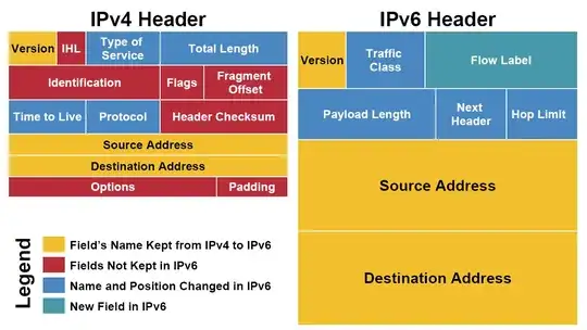

I don't understand what it is meant for "streamlined ipv6 header"? Could you please provide an example?

IPv4 has a lot of fields (14) in the header:
  • Version
  • IHL: Internet Header Length.
  • DSCP: Type of Service.
  • ECN: Explicit Congestion Notification.
  • Total Length: Length of entire IP Packet.
  • Identification: An identification number for fragmented packets.
  • Flags
  • Fragment Offset: Position of the fragment in the original Packet.
  • Time to Live.
  • Protocol: Next level Protocol. (UDP, TCP, etc.).
  • Header Checksum
  • Source Address
  • Destination Address
  • Options
IPV6 designers have reduced this complexity (streamlined the header) to make it easier for routers and network systems to verify each packet and forward it using a routing table.
The IPV6 header has the following 8 fields:
  • Version
  • Traffic Class: 8-bits, the most significant 6 bits are Type of Service and the remaining 2 are used for Explicit Congestion Notification (ECN).
  • Flow Label: Used to maintain the sequential flow of the packets belonging to a communication. The source labels the sequence to help the router identify that a particular packet belongs to a specific flow of information. This field helps avoid re-ordering of data packets. It is designed for streaming/real-time media.
  • Payload Length: Payload is composed of Extension Headers and Upper Layer data.
  • Next Header: Indicates either the type of Extension Header, or if the Extension Header is not present then it indicates the Upper Layer.
  • Hop Limit: This is the same as TTL on IPv4.
  • Source Address (128-bits).
  • Destination Address (128-bits).
The IPv6 header format was designed to keep the header overhead to a minimum.
The non-essential fields and optional fields were moved to extension headers that are placed after the IPv6 header. The IPv6 header can be processed more efficiently at intermediate routers.
