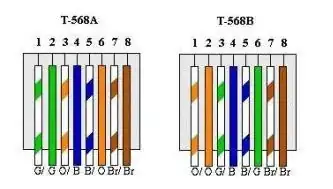

There are two types of pinouts for terminating twisted pair cable with a 8P8C (RJ45) connector:
But why must one not simply align the wires serially, e.g:
Green pair - Orange pair - Blue pair - Brown pair
Why do the current standards offer a nontrivial solution?

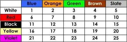

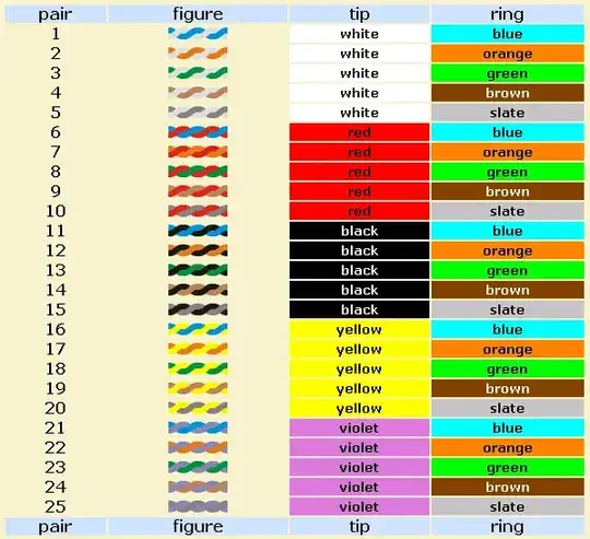

UTP cables used in the 586 standard inherited their color code from the 25 pair color code developed by AT&T for cabling used in telecommunication purposes.
The following table shows the combination of colors to be used for each pair
This gives us this set of combinations:
UTP cabling simply used the first four combinations.
The order used in 586a and 586b is compatible with 1-pair and 2-pair Universal Service Order Codes (USOC) pinouts that are a requirement in federal contracts by the U.S. government.

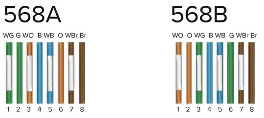

There are two valid standards for the Ethernet RJ45 pin out, 568A and 568B:
The 568A and 568B pin out standards
568A provides backwards compatibility when connecting two phone lines, 568B for only one phone line. 568B also offers a better prevention of cross talk (interference between the cable pairs).
You can use either 568A or 568B, but you HAVE to use the prescribed pairings of the pins:
1 paired with 2, 3 with 6, 4 with 5 and 7 with 8!

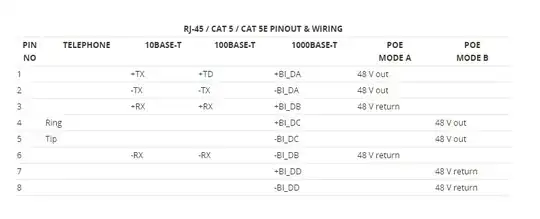

Assignments of the 8 RJ45 pins under different uses
You CANNOT pair pin 3 with pin 4 or pin 5 with pin 6!
Pins 4 and 5 in the middle of the connector ALWAYS have to be paired with one another!
