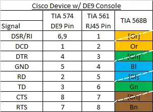

As for the DE9 console ports, the only standard to connect RS232 over RJ45-terminated UTP seems to be TIA-561 (aka RS-232D). When you do that, you end up with the following RS232 signal map to your UTP:
As you can see this results in RS232 signals on the UTP that are different for the different console port types -- and this is with a collection of just three current devices from a single vendor.
