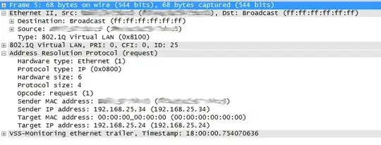

To illustrate, I pulled a random ARP packet out of a random capture I had stored on my computer in Wireshark. Note in this image that the destination is ff:ff:ff:ff:ff:ff (L2 broadcast) in the Ethernet header section but below in the ARP request section the "Target MAC Address" is all zeroes as it should be.
