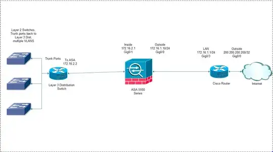

I am working on a lab right now and am having some issues with ASA routing.
Here is the current network topology:
Network Topology
Currently if I login to the console on the ASA or Router I can get outside to the internet no problem. The second I login to the layer 3 switch I can only ping the inside interface of the ASA. This leads me to believe I have issues with the return routing from the ASA.
I want the layer 3 switch to do the intervlan routing (which it is).
This brings up a couple of questions:
  1. Best practice wise - should I let the router or the ASA handle NAT (Overloading)?
  2. I can ping the 172.16.2.2 interface but not 172.16.2.1 from a pc connected to one of the layer 2 switches (proves intervlan routing is working -- i have a 172.20.100.8 address on the PC). Why can't I ping 172.16.2.1 from a PC but I can from the Layer 3 Switch?
  3. I cannot get an ip address right now from the DHCP server (windows). Any insight into why?
  4. And most of all -- Why can't I get out to the internet from the Layer 3 switch?
In the most general of design best practices NAT is performed between an inside and outside network. NAT overloading is generally performed at the edge when there is limited public IP address space. You can learn more about NAT overloading, also known as Port Address Translation or PAT, in RFC 2663 (PAT is referred to as Network Address Port Translation (NAPT) in section 4.1.2).
In this particular scenario you can argue that you have two inside and outside networks and will need to perform some form of NAT on both the ASA (whether that is the NAT overloading you're using now, NAT exemption, static NAT, etc) and the Cisco Router.
The ASA 172.16.2.2 is receiving the ICMP echo-request but does not have a route back to 172.20.100.0/27. The echo-reply is actually being forwarded to the Router 172.16.1.1 via the default route.
And most of all -- Why can't I get out to the Internet from the Layer 3 switch?
Currently your ASA and Cisco Router do not have routes to internal devices other than their connected routes.
Your ASA configuration:
route outside 0.0.0.0 0.0.0.0 172.16.1.1 1
This will provide a default route via the outside interface, but how will the ASA know how to reach subnets residing behind the Layer 3 Distribution Switch?
You'll need to add routes to the internal subnets via the inside interface using the Layer 3 Distribution Switch as the next-hop IP address.
ASA static routing example:
route inside 172.19.12.0 255.255.255.240 172.16.2.2
route inside 172.19.3.0 255.255.255.0 172.16.2.2
route inside 172.20.100.0 255.255.255.224 172.16.2.2
Further reading: ASA static routing
Your Cisco Router's configuration:
ip route 0.0.0.0 0.0.0.0 200.200.200.200
Additionally, how will your border router know how to reach subnets other than it's connected routes, and the catch all default route via the outside interface's next-hop address 200.200.200.200?
Router static routing example:
ip route 172.19.12.0 255.255.255.240 172.16.1.10
ip route 172.19.3.0 255.255.255.0 172.16.1.10
ip route 172.19.100.0 255.255.255.224 172.16.1.10
ip route 172.16.2.0 255.255.255.224 172.16.1.10
Further reading: ISR static routing
I cannot get an ip address right now from the DHCP server (Windows). Any insight into why?
Ensure you have end-to-end IP reachability between the client(s) sending DHCP discover messages and the DHCP server.
From what I can gather from your topology and configuration, the subnets 172.19.3.0/24, 172.19.12.0/28 and 172.20.100.0/27 should have no issues connecting to each other (assuming they are configured to use their respective default gateways) from a networking perspective.
You can remove the ip helper-address syntax from the SVI 100 given that the DHCP server is on the same segment and that command is used for a DHCP server(s) that is on a different segment.

WE dont need any reverse routes for the internal subnets on the edge router because we are doing nat at firewall so every packet which is going out of ASA will be having ip address of the outside interface only (with different Port ) and
this outside interface is directly connected to the edge router so the edge router does not require the reverse routes
