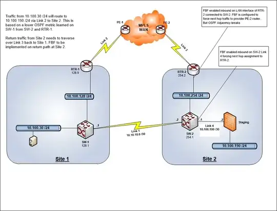

I've built a test lab where I am testing Filter Based Forwarding (FBF), aka Policy Based Routing. Question will follow below, but first, the details:
Below is the topology diagram:
OBJECTIVE: Any traffic destined to Staging from Site 1 should route via Link 2 into the WAN and NOT via Link 1. Since Link 1 will be saturated with replication traffic between the two data centers.
  • SW-1 & SW-2 are Juniper EX4200 switches
  • RTR-1 & RTR-2 are Juniper J4350's
  • PE-1 & PE-2 are Cisco 1841 routers running ISIS and MPLS VPN to simulate provider WAN backbone
SW-1, SW-2, RTR-1 and RTR-2 are all OSPF neighbors in Area 0. Both RTR-1 and RTR-2 are ASBR's and injecting BGP learned routes into OSPF. Each router is advertising routes into the WAN for its respective site (as well as pre-pended routes for the other site for redundancy).
Routing traffic from Site 1 to Staging at Site 2 is easily accomplished by simply redistributing the static route to Staging on SW-2 into OSPF with a higher metric. Since that route gets advertised by RTR-2 into the WAN, RTR-1 will learn that route and redistribute it into OSPF with a metric of 0. The OSPF route learned on SW-1 from SW-2 would have a higher metric, thus routing would be preferred over the WAN.
Return traffic from site 2 also needs to flow this way so that we avoid asymmetric routing. FBF is applied on the inbound interface (Link 4) entering SW-2. This filter will take all traffic sourced from Staging (10.100.190 /24) and make the next-hop RTR-2. This portion of the FBF is working, as I have tested in the lab.
Since RTR-2's preferred route back to Site 1 is via Link 1, we need to apply FBF once again at the inbound LAN interface of RTR-2 (facing SW-2).
Here's the problem... When FBF is applied on that router, OSPF adjacency with SW-2 breaks.
QUESTION: Why is OSPF adjacency breaking between RTR-2 and SW-2??
Configuration for RTR-2 and SW-2 are attached:

So, after working with JTAC yesterday, "I", as in I really didn't need JTAC since I figured out the issue on my own.. realized that my firewall filter was a bit redundant and was lacking a "permit any" statement.
OSPF adjacency was breaking because the firewall filter was taking the "else" traffic (term DEFAULT) and sending it to routing-instance PATH-2, which didn't help either way since it was sending traffic right back to SW-2, something a "then accept" statement would have done easily
So, to repair the issue..
