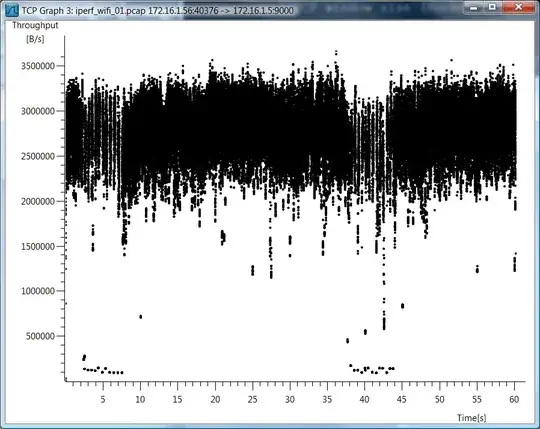

I didn't use iperf -w, so I think there is a misunderstanding. Since you have so many questions about the wifi case, I'm including a wireshark graph of TCP throughput for the wifi single TCP stream case.
Wifi TCP single-stream throughput

  • @generalnetworkerror, TCP windows are not static... they change based on the needs of TCP... during that capture, the maximum window size Tsunami advertised was 1177600 bytes; Tsunami's average window was 1045083 bytes and the average RTT over that 60 second test was 32.2ms. – Mike Pennington Sep 18 '13 at 11:44
