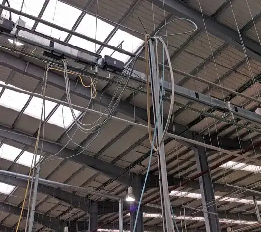

I am doing some work in a factory that is quite new, and have been asked to terminate some network cables - simple enough.
However on looking up at the cable trays, which are suspended from the ceiling, I see in various places, "Someone" has run 3-phase power cables in-amongst the (eg aprox 20) cat7 cables, for many meters, they have also CABLE TIED a network cable to that power cable as they are dropped down to each machine.
I was always taught that running network cables and power/lighting together was a no-no.
Am I right to be concerned about this? or is Cat 7 fairly interference-proof?
Edit: Photo added for general amusement - one of many examples. light blue = network, silver = power (coming from the power conduit, through the network tray and then down...
