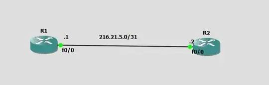

Why do I get % Warning: use /31 mask on non point-to-point interface cautiously when I use a /31 subnet mask over Ethernet, and why am I not able to ping from R1 to R2 when both the interfaces have accepted the /31 subnet mask and they both are directly connected, and in which conditions can I use /31 without any trouble?

Topology:

Your problem is that you are addressing in two separate networks: 216.21.5.0/31 and 216.21.5.2/31. The addresses you are using are in the same /30 network, but two separate /31 networks.
You need to set one address as 216.21.5.0 and the other address as 216.21.5.1, or set one address as 216.21.5.2 and the other address as 216.21.5.3.
The warning is because ethernet is a broadcast technology which can have multiple endpoints, but a /31 network can only use two endpoints. If you were configuring it on a true point-to-point medium, I don't think you would get the warning.
