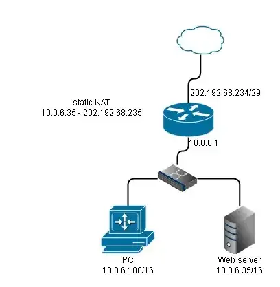

I have a Cisco router configured NAT (4 static NAT and dynamic NAT). My problem is that I can't access internal servers using public IP addresses from the internal network.
I know what the problem is. I did a lot of Google searching about this problem, and I learned that most firewall/routers automatically handle this situation.
In case of Cisco, NAT hairpinning is the one of the solutions (I don't know if I am correct). How can i do that?.
i need to access the server using the IP address 202.192.68.235 from my PC, but I can't.

  • Can you post a diagram and configuration of your router? There's not enough information to help you. – Ron Trunk Dec 22 '15 at 11:54
  • edited my question. hope this will help u – sareeshmnair Dec 22 '15 at 12:06
    Unfortunately, you can't make the router do what you want. You can't use the outside address to get to the server in the configuration you have. – Ron Trunk Dec 22 '15 at 15:58

This is a case of port forwarding to the same network. For such DMZ's setups, hairpinning is preferred or having local DNS to resolve for such internal servers. Apart from them there is an equivalent solution for it.
The solution is to have DNAT rule for your LAN zone also so that the packet with destination ip 202.192.68.235 from local client can be translated to 10.0.6.35 and routed back to the same network by the router.
But again the problem is that the server will try to reply directly to the client since it belongs to the same network. Now to make the server reply the client via router we need to add an SNAT rule that would make the source as router.
Your SNAT rule should be very specific such that it applies only for traffic coming from local subnet and destined for 10.0.6.35. This will solve your problem for sure.
To summarize you have to add a DNAT and an SNAT rule for LAN interface.
