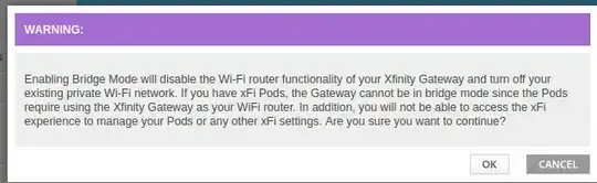

Modem In Bridge Mode
I tried to set the Modem into Bridge mode and had a very unpleasant 90 minute period where my internet access was down and had to endure some very angry users. I'm guessing I failed to configure the Router WAN port correctly. Probably because it was in DHCP mode. I'd like to try to set it to a static address (e.g. 10.0.0.2/24), however I'm a little gun shy about Bridge Mode, right now. Google generates plenty of hits when searching for "Comcast Bridge Mode", however I haven't been able to make much use of what I found. I haven't been able to find a good incantation for Router WAN port configuration with Comcast Bridge mode.
As an aside, the Comcast bridge isn't entirely transparent, the Modem retains its IP address (10.0.0.1) to which I can connect via http and reconfigure (fortunately) when I attach a laptop directly to it Port 1 on the Modem. So, my laptop understands how to deal with the Modem in bridge mode, even if the Router does not.
I'm also confused how in Bridge Mode the Router gets dynamic settings from Comcast ISP (for DNS and default Gateway, etc.) like it would with DHCP. Or, if these are not really dynamic and I should just hard code them in the Router configuration file.

Pic of My Modem
Description
Since you have a router externally as well, there really is no need for 2 routers. That's where literal signals get crossed. I am sticking with my original recommendation to save yourself some money and take back control of your network. (Notice Xfinity's Modem has several important options greyed out)
