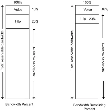

Also, the bandwidth remaining percent command is a bit tricky: Each instance actually allocates n% of the remaining available bandwidth, not n% of the total. This graphic from an article by Arden Packeer should help illustrate the idea:
'Bandwidth' vs 'bandwidth remaining'
It's important to note that any classifications you define need to match what your WAN provider supports. Most providers offer only a handful of pre-configured QoS profiles from which you must choose which best suits your needs. You can classify however you'd like on incoming traffic at the WAN edge, but the provider's QoS controls are what control the the treatment of traffic during transit across the WAN.
