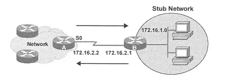

Rephrasing: I want to know if Router A need to be set by a network administrator of Stub Network...
I meant about the IP configuration.. Router A belongs a stub network? In this case the IP configuration for Router A, Who do? Administrator of Stub Network or ISP ( If Router A not belongs a Stub)
Stub Network

  • sorry about that, I meant about the IP configuration.. Router A belongs a stub network? In this case the IP configuration for Router A, Who do? Administrator of Stub Network or ISP ( If Router A not belongs a Stub) – Shinomoto Asakura Feb 22 '15 at 13:23
  • "Stub Network" is a network accessed by a single router! On the left-hand side of the diagram are others networks! Static routing is used often in kind of network! The router A is being configured with a Static IP for access the Stub network.. Assuming that my company is that stub network and I'm network administrator, Who will configure the IP in Router A? Me or a ISP? – Shinomoto Asakura Feb 22 '15 at 16:32
There is a very basic notion here. The person that owns a thing has responsibility for its configuration.
  • If you own Router A, then you configure it.
  • If your ISP owns Router A, then the ISP configures it.
I can't imagine a IT world which operates otherwise and actually works reliably.
Incidentally, the network behind Router B is not commonly called a "stub network" in English. It's just called "my company's network" or "the network behind Router B".
When you say "stub", that carries a loaded meaning to network professionals, particularly since OSPF has stub networks; so does EIGRP
