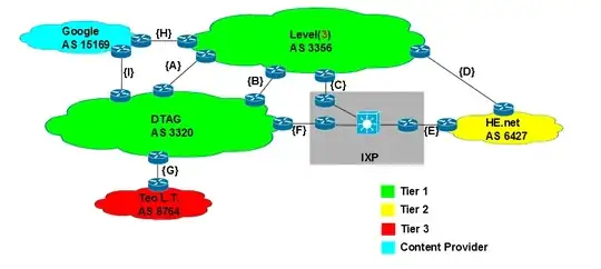

John Jensen did a fantastic job explaining how this works overall, but I suspect a diagram could help. I will borrow the example providers he used.
Let's assume you have a web server colo'd in an HE.net facility; assume you pay HE.net $500/month for a 100Mbps co-colocation. All HE.net's transit and upstream provider's fees are passed through to HE.net's customers.
When someone on Teo L.T's network pulls a page from your server, the traffic has to go through HE.net, (potentially) Level(3), DTAG, and Teo LT.
Sample topology
As a Tier 2 provider, HE.net needs to buy transit from Level(3) (Link {D}) and HE.net also buys bandwidth from an IXP (Link {E}). Those transit / IXP fees are paid for by HE.net's customers and any other revenue streams that HE.net might have (such as selling off some HE.net spare fiber capacity).
An imaginary breakdown of who pays who for peering, transit and IXP colo is shown below...
Link | Link Type | Buyer      | Seller
{A}    Peering     N/A          N/A
{B}    Peering     N/A          N/A
{C}    IXP         Level(3)     IXP
{D}    Transit     HE.net       Level(3)
{E}    IXP         HE.net       IXP
{F}    IXP         DTAG         IXP
{G}    Transit     Teo L.T.     DTAG
{H}    Transit     Google       Level(3)
{I}    Transit     Google       DTAG
Caveat: This diagram may have no resemblance to real peering / transit / IXP relationships; purely for purposes of illustration.
