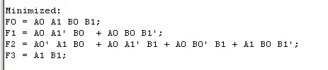

After the truth table is complete, you could fill this into a karnaugh map, and derive the equations for each output of the circuit. In this case, I let this handy program do it for me.
The output came to this.
Logic Friday
At this point, you can see that I have an equation for F0 through F3 based on the inputs. Now I just need to throw in the logic gates to match those equations. And voila, you have a circuit that performs binary multiplication.

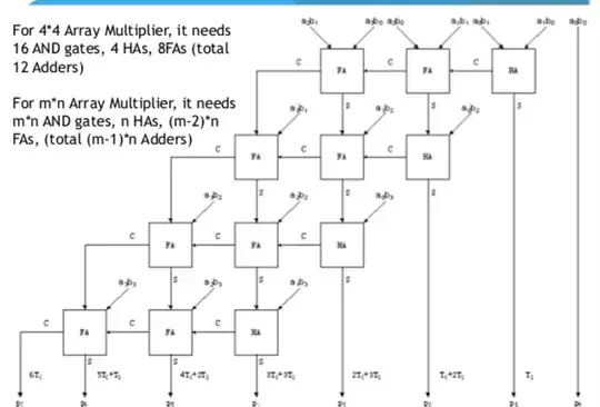

Write the multiplication down and you'll know what to do. For example A2A1A0×B2B1B0
            A₂   A₁   A₀
         ×  B₂   B₁   B₀
          B₀A₂ B₀A₁ B₀A₀
+    B₁A₂ B₁A₁ B₁A₀
B₂A₂ B₂A₁ B₂A₀

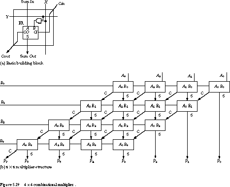

As you see, just multiply each bit (which is accomplished by an AND) then add them together using full adders. Here is an implementation
3-bit array multiplier
Here is a different way to draw the implementation
another 3-bit multiplier implementation
Most other online examples are 4-bit multipliers but you can modify it easily to make a 3-bit one

  • Don't you have to plug the carry from the last row, into the Sum in of the next column? I.e, $$\operatorname{Carry_{out}}(A_0B_3) \to\operatorname{Sum_{in}}(A_3B_1),\\ \operatorname{Carry_{out}}(A_1B_3) \to\operatorname{Sum_{in}}(A_3B_2),\\ \operatorname{Carry_{out}}(A_2B_3) \to\operatorname{Sum_{in}}(A_3B_3)?$$ – YoTengoUnLCD Dec 10 '16 at 22:41
  • @YoTengoUnLCD the carry must be done in hardware. Here I just write out a multiplication like you do on paper. How it's implemented is left for readers – phuclv Dec 11 '16 at 03:02
  • Sorry, I wasn't clear. I meant that in the picture with the 4 by 4 bit multiplier, I believe the carries should be wired as I said above, I tried that circuit a while ago, and it gave a wrong answer for $$0011_2\times 1111_2$$ – YoTengoUnLCD Dec 11 '16 at 03:29
  • yes may be you're correct. I took the image from internet without checking its content – phuclv Dec 14 '16 at 15:42
