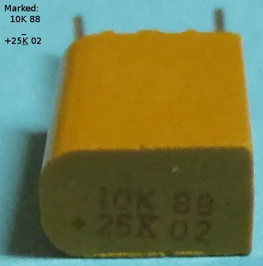

I got some capacitors about two years ago now, which I foolishly removed from their bag, and I quickly forgot their markings. I can't even figure out which kind of capacitor it is. Tantalum seems the most similar, but the markings are wrong for a tantalum cap. Could you please help me identify this?
Help me identify this!

The stylized K is a trademark of Kemet, who makes both ceramic and tantalum caps.

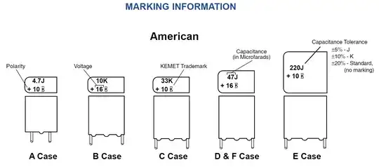

The polarization marking would indicate tantalum, but the capacitance (if it's only 10,000pF) is rather small for a 25V rated tantalum cap.
My best guess is that this is a 10uF +/- 10% (K tolerance) 25V solid tantalum capacitor.
Edit:
Turns out it was a pretty good guess. Here's the data sheet (towards the back). It's a MIL-spec solid tantalum cap.

  • They were in their original packaging at a HAMfest; the stickers were freshly printed. When i've used it in circuits, it seems about equivalent to a 10uf capacitor, but if i flip it around, it seems like it has a little more capacitance... I really don't know what to make of it. I think I remember the seller saying they were good for, well, radio equipment or something (may not help much; we were at a HAMfest after all). I don't think they are from '88. – Wyatt Ward Feb 10 '14 at 01:38

  • I think I found it! THANK YOU GOOGLE IMAGES! I think it's the t340 or t370 series. http://www.kemet.com/kemet/web/homepage/kechome.nsf/weben/547892805FE03DD7CA2570A600107AD6/$file/F3100.pdf – Wyatt Ward Feb 10 '14 at 02:11
  • See my edited answer above – Spehro Pefhany Feb 10 '14 at 02:53
  • Awesome! I'm a bit suprised I got a military spec capacitor at HAMfest. I guess it will just work really, really well. – Wyatt Ward Feb 10 '14 at 14:09

Alright, it took a while, but with google images I found it, I think.
I think it's the Kemet t340 or t370 series - series datasheet here
