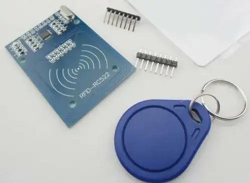

I am working on a prototype, one function of which is to detect whether an object is "in range" by a few cm. Right now I'm just using an Arduino and a cheap Mifare RC-522 kit that operates at 13.56 MHz:
Mifare RC522 Kit
I've successfully gotten it to detect the tag, but only at a distance of about 3-4 cm when the tag is oriented parallel to the antenna.

  • Ditch the embedded antenna on the cheap RFID reader and construct my own, larger antenna. I'd need to see if the onboard MFRC522 is up to the task of providing additional power.
