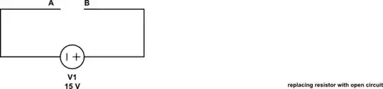

Here's how I like to think of it: if the resistor has infinite resistance, just replace the resistor with an open circuit:
Now, do we want to say that there is no voltage drop between A and B? We can actually get rid of the wires, if we assume that the wires are ideal and don't have any resistance:
simulate this circuit
So the claim is that this schematic is equivalent to your circuit if the resistance of the resistor is infinite. Or very large, as it is in (unionized) air.
