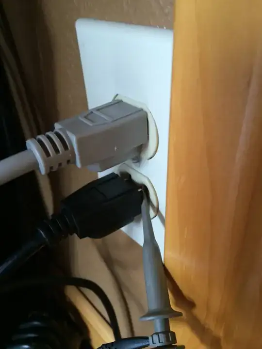

I just tried this. To be safe, I verified that the outlet was properly wired, e.g. hot and neutral are not reversed, no open ground, no open neutral. I also used the same outlet as the scope is connected. That way, the grounding is already happening inside the scope and reduces to possibility of a ground loop. I connected the grabber to the hot (small) side of the plug as it enters the outlet. The little gap creates a low risk of accidentally touching it.
Bottom line, it worked, and I lived to tell about it. And got pics to prove it. Signal looked clean, very little harmonics and noise.
