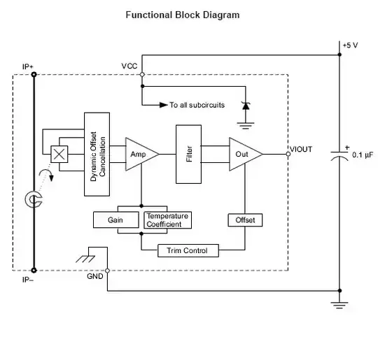

  1. Hall effect, isolated current path, linear current sensors:
    For measuring current of up to 20 or 30 Amperes full-scale, Hall Effect linear current sensors such as the Allegro ACS713 family provide unidirectional isolated high-side current measurement, with an internal shunt resistance of 1.2 milliohms along the current path. For bidirectional current sensing, the ACS712 provides the same functionality, and also has a 5 Ampere full-scale option.
    For a full-scale range of 50 or 100 Amperes, the ACS756 series, similar to the ACS713, offer a 130 µΩ internal shunt resistance along the current path.
    Both these current sensors provide a ratiometric output, so output voltage ranges linearly up to the IC's supply voltage (3 to 5 Volts), in the ratio of sensed current to maximum rated current (20, 30, 50 or 100 A depending on specific variant used).
    Schematic
    Since the current sense path is electrically isolated from the rest of the IC (shown in diagram above), the sensed current is independent of the battery voltage, at least up to several kilovolts. As an added advantage, these sensors can be used on the high or low side without any changes: The output is ground-referenced with excursion up to Vcc of 3 to 5 Volts as applicable.

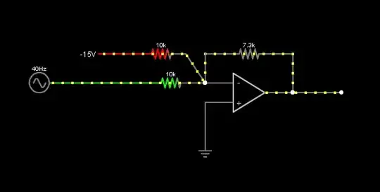

As far as converting your voltage range of 10.5 to 15V into 0 to 3.3V, an op-amp can take care of this.
This is one of my favorite features of op-amps.
Have a look at this circit.
In order to achieve attenuation, you must use an inverting op-amp configuration. Now the DC offset in your 10 to 15V range is of course 12.25V, so by applying a DC offset of -15V to the op amp, your signal is presented as a -4.5V to 0V signal, which gets attenuated by a factor of 0.733, and gets inverted.
Might be hard to see from that picture, so this might be better.
As far as accuracy, I'm not entirely sure if this could work so maybe someone more knowledgeable could chime in, but perhaps you can also do this attenuation with a more accurate instrumentation amplifier.
krb686
  • 1,215
  • Thanks! That looks like a possibility, although the -15v supply might be a bit difficult. What is the 40hz input for? Which is the signal input? – user36427 Feb 01 '14 at 00:04
  • @user36427 The 40Hz signal is just the default value of the AC source in that simulator. That was just to show you how it converts the voltage range of the signal, in the two scope displays in the first picture. You could stick in any frequency and it would do the same. Essentially the op-amp just does this operation --> – krb686 Feb 02 '14 at 00:12
  • @user36427 Vout = (Vin - 15) * -.733333, which translates 10.5 - > 3.3, and 15 to 0 – krb686 Feb 02 '14 at 00:12
