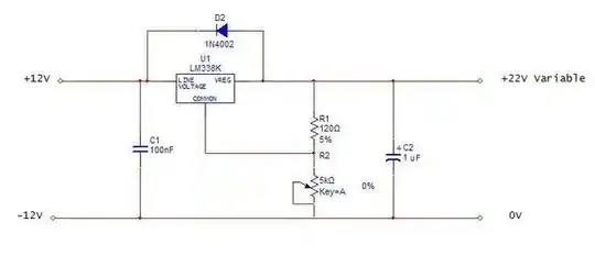

In this guide, there is a schematic to take the +12V and -12V lines and combine them with a potentiometer to output a range of voltage up to 24V.

Upon testing the circuit, I connected a voltmeter to the 24V output and ramped up the potentiometer. It released its' smoke about halfway up, so I aborted the test and connected the leads that went to the (now dead) potentiometer to an ammeter. I figured maybe there was too much current for the potentiometer. Shortly after powering on the supply again, the voltage regulator in the circuit below fizzled out of existence and I killed the power before any further damage could take place.
My theory is that I'm not understanding how this 24V is being produced properly, and that perhaps the ground from the LED on this connection is somehow causing everything else to fail. Or, that the potentiometer couldn't handle the amperage, and perhaps the LM317 died because there was no heat sink and it simply overheated. I'd like to know (a) if my theories are correct, and (b) if there is a way to fix this and allow it to function the way I am expecting. It's hard for me to understand how the 24V variable line is not grounded and can still work properly, and perhaps I shouldn't be attempting to build a circuit I don't completely understand.

    The "zero volt" terminal of this 1 - 22 Volt supply must not be connected to the ATX supply's 0 volt/ground terminal - it is actually connected to the ATX -12 volt terminal. – Peter Bennett Jan 29 '14 at 03:23
    It would be good to have a schematic of exactly what you built, instead of a schematic of what you were trying to build, to which you added things and made modifications. – Phil Frost Jan 29 '14 at 03:31
  • (https://dl.dropboxusercontent.com/u/100633515/Photo%20Jan%2028%2C%2020%2052%2003.jpg) Here is a picture of the schematic of what I'm doing with that variable voltage circuit. It seems like the ground from the LED is causing the short, but I guess I had figured that the path from +12V to ground would be taken through that as normal, and the +24V variable circuit would be isolated. – Mathew Tate Jan 29 '14 at 03:58

Each of the 3 power rails (3.3V, 5V, +12V) are connected to a fuse, then to a binding post, while the negative binding posts go to ground.
This sounds like the problem. Keep in mind, voltages are differences in potential between two points. There's nothing special about ground, it's just an arbitrary point which we pick. It's 0V because the difference of something with itself is 0.
You can call anything you want "ground". That's why this circuit works. If you call the -12V output as "ground", then everything else is 12V higher. That's including what was previously called "ground": now it's 12V, because it's 12V more than what you are now calling ground.
Now consider what you've done:
The "ground" of the power supply connects all of the voltages supplied together (connections labeled B and C). The output voltages are relative to this. Notice how the -12V (V4) makes a negative voltage because it's positive side is attached to "ground".
Then, you attached the negative binding posts of all the supplies together. Largely this is redundant: you are duplicating connections B and C. But you are also adding connection A.
See the problem? You've shorted out V4. A wire has ideally zero resistance. By Ohm's law, the current that will flow is:
$$ \frac{12V}{0\Omega} = $$
divide by zero error
In reality, the wires used to make this connection actually have some very small resistance, and you get a whole ton of current. This far exceeded the current the voltage regulator can handle and the smoke got out.

    I understand your post, and you may be accurate, but not precise; I'm sorry if I didn't explain properly, and please note the schematic I posted in a comment to the above post. While the 3.3V, 5V and 12V lines are grounded, the 24V variable circuit *should* have it's own isolated ground (that is, the 0v from the circuit in the original post is the "ground" for the 24V binding post's ground, not common ground). However, I did find a short from the positive terminal to common ground which would essentially cause the same thing, so in that, I believe you're correct about the cause. Thank you! – Mathew Tate Jan 29 '14 at 04:08
