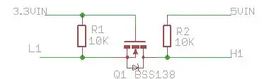

A very simple bidirectional level translator can be made with a single N-mosfet:
The mosfet used should be a model with a low Vgs threshold, so that it can have a relatively low Rds-ON (ON resistance) at the intended input voltage level (3.3v in this case).
BSS138 in one such example, it has a Vgs-th of 1.5v max and is specified to have a low drain-source resistance with Vgs voltages as low as 2.5v (maybe slightly lower too).
The shown example uses 3.3v <-> 5v translation but it can also work with 2.5v <-> 3.3v or 2.5v <-> 5v, even between 2.5v <-> 12v. The range is only limited by the characteristics of the mosfet used.
The shown circuit is based on an application note from NXP
AN97055 Bi-directional level shifter for I2C-bus and other systems
New shorter version: AN10441 Level shifting techniques in I2C-bus design
When L1 is high (3v3) or floating R1 keeps the mosfet off so R2 pulls the drain side high (to 5v).
When L1 is pulled low then the mosfet conducts and the drain becomes low.
When a low level (0) is applied to H1 then that voltage is transferred through the substrate diode to the source side (L1)

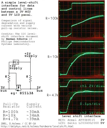

Please note that the resistance size can affect the speed (image source)

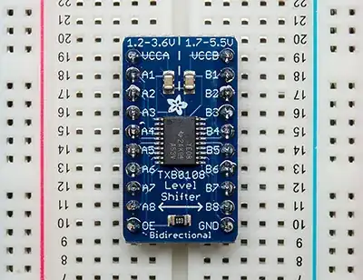

Since the question seems oriented towards an IC that provides bidirectional level shifting, consider the Texas Instruments TXB010x family of parts: TXB0102 has 2 channels, TXB0104 has 4 channels, and TXB0108 has 8 channels.
The stand-out feature of this family of ICs is that signal direction is automatically sensed, so a separate direction setting pin is not needed.
Switching speeds up to 10 MHz work reliably. The theoretical maximum speed may be higher - the datasheets are not explicit about this from what I can determine.
I have a TXB0108 working between a 3.6 Volt MSP430 Launchpad and a 5 Volt Arduino Nano, so the use case of the question is covered.
For the purposes of trying it out, Adafruit offers a prebuilt module incorporating the TXB0108, which saves you the trouble of soldering an SMD part. There may be similar options for the 0102 and 0104 from them or others.
8-channel Bi-directional Logic Level Converter - TXB0108

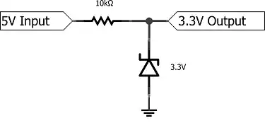

Another thing you should consider is whether you actually need level shifting at all. Many chips have 5V tolerant input pins even when running at a voltage lower such as 3.3. The atmega CPU also interprets anything above 0.6*Vcc or 3V for an arduino as a logic high, so a 3.3V signal can directly drive an arduino pin with no level shifting.
Assuming you are using a 5V arduino and need to talk to a 3.3V part, if the part has 5V tolerant inputs (many do nowadays), just connect em up and it will work. If your bidirectional line is an open collector design, such as i2c where the devices only pull the line low then just attach the pull up resistors to 3.3V instead of 5V and things will just work.
Otherwise all you need to do is make sure the line doesn't go above 3.3V, you can do that with a resistor and zener, put a resistor on the arduino line then a zener to clamp the voltage to 3.3V. zener resistor clamp
(source: repetae.net)
You may be tempted to live dangerously and just use the 10k resistor and nothing else. The reason this (sometimes!) works is that there is a clamping diode inside the recieving chip that shunts excess voltage to vcc or 3.3V. This diode will burn out if you try to pull the entire 3.3V line up to 5V through it (in addition to whatever damage caused by pulling that line to 5V), however with the resistor not much current will flow and assuming your 3.3V line has a non-trivial load on it it won't change the level of your power line substantially but there are lots of caveats. So, in general, don't do this unless you have a local, isolated 3.3V bus and really can't spare the extra two cents for the zener. I only mention it because you will see it in schematics for dirt cheap breakout boards you get on ebay and might be tempted to copy it, just don't let it sneak past the breadboard into a production design. :)
Edit just noticed you were using the newer 3.3V arduino, so just invert what I said above, the zener resistor trick will still work although apparently some of the i/o lines on the due may be 5v tolerant, there seems to be some disagreement on the forums. The teensy 3.1 is also a nice little ARM board that has all 5V tolerant pins and is less than half the cost of the due and better designed IMHO http://www.pjrc.com/store/teensy31.html

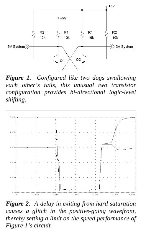

From the cheap[er?] solution department, the FET (from the accepted answer based on the NXP appnote) can be replaced with a BJT and Schottky diode as in Silicon Labs AN883. Their schematic is a bit complicated with other things, so I've extracted the essential bit here and reoriented it so it looks like in the accepted answer for easy comparison of the two schematics:
The BJT does translation in the low->high direction only... exactly as discussed in Single transistor level up shifter. The Schottky replaces the body diode of the FET for the high->low translation.

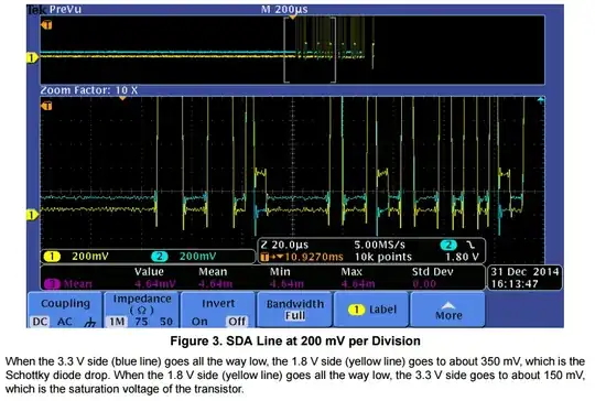

Below is their zoomed in scope measurement for a 3.3<->1.8V translator; they also propose this schematic for 5<->1.8V translation etc. When doing 3.3<->1.8V translation a MMBT3904 had only 150mV (saturation) drop. The BAS40 diode had 350mV drop in the opposite direction. These offesets affect (obviously) the logic-low level output on the low and respectively high side of the translator.
They had nice CMOS devices on both sides, so input impedance wasn't much of an issue. There was no visible degradation/offset of the logic-high margins in their 1V/div trace, so I haven't bothered including it here. The input impedance of their devices were at least 1Mohm from what I can tell from a simulation. Logic-high margins start to degrade below 100K input impedance or so.
Also, they recommend this BJT-based translator only up to 300KHz or so.
I'm not sure which of these solutions is cheaper in practice, FET or Schottky + BJT... but this one certainly needs more parts... unless you use one of those diode+transistor packages, which do exist, e.g. PZMT1101. But you also need 3 resistors.
