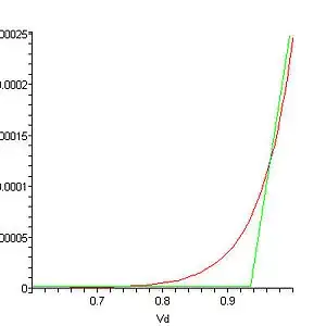

  • The dynamic resistance depends of the general forward characteristics of the diode (or other power semiconductor), which is a complex logarithmic function with at least 3 constants. So to determine the mean power loss we must have an accurate instantaneous forward voltage and the related instantaneous current. An approximate slope of the resistance Rt and threshold voltage we can get from curve simplification (consider two straight lines joined at knee point Vto). With this method, and with average current known plus the conduction angle, we are able to calculate the Average Power Loss – GR Tech Jan 28 '14 at 08:04

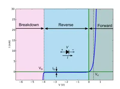

For any two-terminal device, or for any two terminals of any device, we can graph current vs. voltage. For a purely resistive device, this is a straight line passing through the origin, and the slope is the inverse of resistance. For a non-linear device, like a diode, it's not a straight line (that's what not linear means). Example:
diode current vs voltage
At any point, the slope of this line is the dynamic conductance; the inverse of that is the dynamic resistance. For example, in the reverse region, the line has a very low slope, a very low conductance, or a very high resistance. In the forward region, high slope, high conductance, low resistance.
\$P=I^2r\$ does not hold if \$r\$ is the dynamic resistance. \$P=IE\$ does, however.

Phil Frost's answer is great. I'd just like to add that as a rough approximation, it's often possible to model a diode (or other junction drop, like a BJT or IGBT) as a voltage source in series with a resistor.
So for large-signal purposes, you can estimate the losses through the diode as: $$ P=I_{mean}V_{D} +I_{RMS}^2R_D $$
Whether this estimate gets you close enough or not depends entirely on your domain, but I've had good success with it for narrowing down my component selection in switching power supplies.

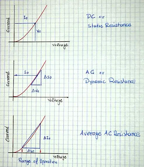

how is it different from the normal resistance R=VI?
It is different because it is dependent of the current we are letting through the diode, which gives different apparent values of resistance. The normal resistance R = VI will appear always same when you measure it on a resistor ( apart from minor deviations ).
Does the equation for the voltage drop work if we use the dynamic resistance with the instantaneous current (V=Ir)?
It does, because 'r' is defined such that it shows the apparent resistance of diode, with regard to given current and voltage. However, for the real picture, looking at the V/I characteristic of a diode would be a better choice.
