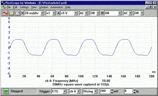

Consider an extreme example, a base frequency of 10 MHz, but a tiny bandwidth, of 1 Hz. All you can really do with this channel is emit a 10 MHz sine wave.
In response, one might say: "But I can turn that sine wave on and off to encode my ones and zeros," but the rate at which you can switch is dependent on the bandwidth. After all, the tiny bandwidth suggests a pure sine wave.
If you take alternating 10 MHz sinewave with silence (to represent ones and zeros), then apply a Fourier Transform, which will find the frequency content, you'll notice there is a lot of much higher frequency content. The ability to create the sharp transitions requires the higher bandwidth.
Finally, consider a physical example. An example of a channel with a small bandwidth would be resonance. When you excite a resonator, it will start to ring. As soon as you try to shut it off, it will continue to ring and take a long time to decay, essentially preventing you from transmitting a zero.
