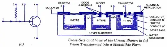

Most commercial IC circuits are isolated from the substrate material by a reverse-biased P-N junction (including CMOS parts). The substrate is usually tied to the voltage expected to be most negative.
If it isn't, then that junction becomes forward biased and can conduct a great deal of current, melting metal or heating the junction to the point where it no longer acts as a diode. That is typically at a voltage of about 0.6V, but the IC makers play it safe usually by telling you not to go lower than -0.3V.
(referring to the below diagram, but not shown, the substrate would be tied to pin 5)

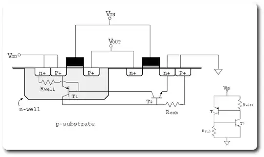

Most CMOS parts have another twist that if part of the chip has a normal Vdd and another part sees a big negative current it will trigger a big parasitic SCR that is a side effect of the structure, then the device's power supply draws a large current which causes overheating, melting etc. if the current is not externally limited. That is called latch-up.

    Nice answer, lots of upvotes, unfortunately it is incorrect. Latchup is a different phenomenon. In IC design it can be avoided by having enough substrate contacts, this is also checked during design with automated tests. – Bimpelrekkie Jun 16 '15 at 15:40
    @Rimpelbekkie Nope. The trigger current can be increased, but the effect cannot be eliminated totally except by going to an insulating substrate such as sapphire because the four layers of a thyristor are still here. The current is not limited in the situation under discussion here. – Spehro Pefhany Jun 16 '15 at 15:51
    Nope what ? Latchup is a real phenomenon, no doubt there. Is it the reason that a lot of current flows when the supply is reversed ? NO ! If you disagree, explain to me how the thyristor equivalent circuit pictured above can conduct when VDD is negative with respect to ground. To trigger the thyristor, VDD must be positive and enough voltage must exist across Rwell and/or Rsub. This can only be caused by having too few and too distant substrate contacts. I have been designing ICs for 25 years, have yet to see one with a latchup issue. – Bimpelrekkie Jun 16 '15 at 17:26

Latch-up as mentioned above is an effect that occurs when the supply has the correct polarity but a current is sinked or sourced on an input or output causing a malfunction as explained above. It has nothing to do with reversing the supply ! If you think I'm talking nonsense then please look up how a Latch-up test is performed. There is specialized measurement equipment to do such test.
Please read this excellent article explaining latchup and note that the supply is "normal" so not reversed ! When still in doubt read the EIA/JEDEC STANDARD IC Latch-Up Test EIA/JESD78.
