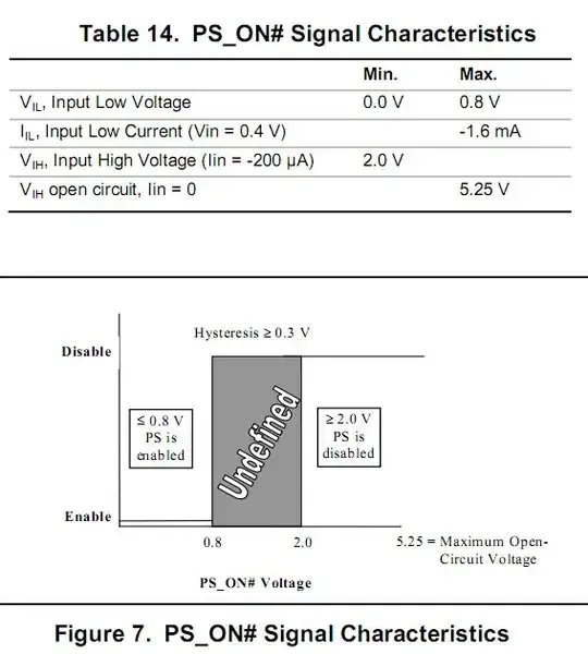

There is no need for a resistor. Any voltage <0.8 (or ground connection) will enable the psu
Refer to ATX12V Power Supply Design Guide section 3.3.2
PS_ON# is an active-low, TTL-compatible signal that allows a motherboard to remotely control the power supply in conjunction with features such as soft on/off, Wake on LAN*, or wake-on-modem. When PS_ON# is pulled to TTL low, the power supply should turn on the four main DC output rails: +12VDC, +5VDC, +3.3VDC and -12VDC. When PS_ON# is pulled to TTL high or open-circuited, the DC output rails should not deliver current and should be held at zero potential with respect to ground. PS_ON# has no effect on the +5VSB output, which is always enabled whenever the AC power is present. Table 14 lists PS_ON# signal characteristics. The power supply shall provide an internal pull-up to TTL high. The power supply shall also provide de-bounce circuitry on PS_ON# to prevent it from oscillating on/off at startup when activated by a mechanical switch. The DC output enable circuitry must be SELV- compliant. The power supply shall not latch into a shutdown state when PS_ON# is driven active by pulses between 10ms to 100ms during the decay of the power rails.

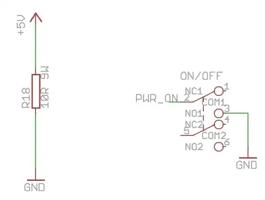

I did the same except designed an ATX breakout board with a 10 watt for 5 volt or a 15 watt resistor for the 12 volt rail. Some power supplies are different requiring the load resistor on the 5 volt rail and some on the 12 volt rail. I used a on off on switch attaching to both rails then to the load resistor that way I can use any such power supply regardless of rail load. each power rail voltage has it's own layer so I can ramp up the amperage to 20. Still looking for the 3D binding posts that handle 30 amps. I added the 4x4 CPU also because it has 4 12v lines and 4 ground lines as the 24 pin only has two 12 volt lines and I did not feel safe with just two at 20 amps so the plug was added. ATX breakout board with load resistor

I am working with a PSU and I had to put a load on it to make it work. I added a 10 ohms 25W to the 12V output of the ATX connector.
