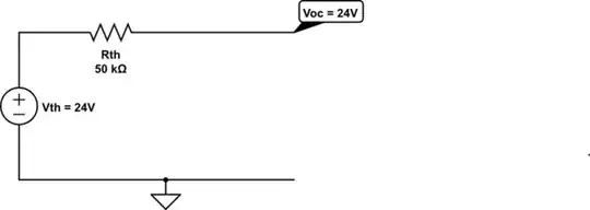

Indeed it does. Perhaps the most illuminating way to see this is to form the Thevenin equivalent of the voltage divider (without the added parallel load).
The actual circuit:
The Thevenin equivalent circuit is
simulate this circuit
By Thevenin's Theorem, the voltage across an added load resistor will be identical for both circuits.
It's easy to see in the equivalent circuit that an added load \$R_L\$ forms a voltage divider with the equivalent resistance and so, the voltage across \$R_L\$ must be less than 24V:
$$V_L = 24V \frac{R_L}{50k\Omega + R_L} \lt 24V $$

One way to look at this is to characterize the voltage source produced by the voltage divider. It so happens that any ideal voltage source with some resistive network after it can be modeled as a single voltage source with a single resistor in series. This is called the Thevenin equivalent. It is often useful to simplify more complicated voltage sources into their Thevenin equivalent.
In your case, you have:
Which as you say will produce 24 V when left open. The Thevenin equivalent of what you have is:
Note that from the point of view of any circuit connected to Vout, these two sources can't be distinguised. That's what Thevenin equivalence is all about.
Now it should be obvious what happens as the source is loaded. It will be 24 V with 0 current. Any current drawn will also flow thru R1, which causes a voltage drop accross R1, which subtracts from the 24 V source voltage as seen by the output. This relationship is linear. We already have the point with 0 current. Another point that gives us some intuition is the 0 voltage case. If you short Vout, all the voltage will be accross R1. By Ohms law, the current thru R1 is 24 V / 50 kΩ = 480 µA. Therefore as the current drawn from Vout varies from 0 to 480 µA, the Vout voltage vary linearly from 24 V to 0.
As one more example, if you draw 100 µA from Vout, then R1 will drop 50 kΩ x 100 µA = 5 V, so Vout will be 24 V - 5 V = 19 V in that case.
