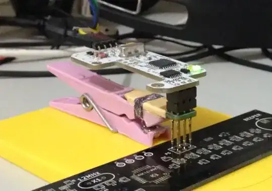

I would say pogo pins
pogo
attached to a small peg that can "bite" the pcb, similar to the following but using smaller pegs with one pin in the tip of each one.
alexan_e
  • 11,070
  • 62
  • @RafaelRivera I guess it may take a couple of tries to get it right but I think it's worthwhile. You can make a few single pins mounted on mini pegs and a couple that have a group of pins and attach to specific pad patters you may use often like ISP/jtag connections in mcu boards. There are many types of pogo pin tips, the ones with a sharp tip will probably fit best since they don't slip away. – alexan_e Jan 21 '14 at 22:47

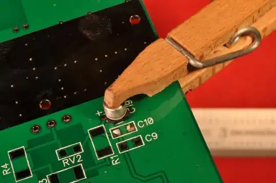

Since there is no scale to the picture to say how big the pins are, it's hard to suggest a size of wire to use. Let's use 24awg. Since one point (TP12) is tied to ground, you can grab that anywhere on the board. The other (TP11) looks to be a Vcc type, so you can grab that from anywhere that voltage is at, or don't use it if not needed. So the two important ones are TP9 and TP10. In either case, you strip the wire a few MMs, then you hammer the ends flat, to give them a bigger surface area. Since they are near the edge, a nice flat clamp will hold them in place. (or plastic covered paperclip, or a clothspin, depending on how much space you have to work with) You want the pressure to be on the wire, not the coating, other wise the wire will lift up and you will not have solid contact.
Imagine this but with wires:
