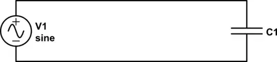

But now consider this. If I use a capacitor as a load to some AC voltage source, some current will flow (the precise amount depending on the voltage, frequency, and capacitance):
I know that current is flowing all the way around this circuit, because if I put a lightbulb on either side of the capacitor, it will light. But if the current is flowing around this circuit, how does the capacitor "store charge"? In other words, how can I ever put electrons into the capacitor if the current is flowing around the circuit, which means for all the electrons I put in the capacitor, the same number come out the other side? If I can't put electrons in without taking some out, then how can the capacitor be storing them?
