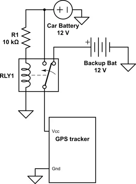

It can be as simple as a relay that connects your backup battery.
The resistor can be as high as needed to trip the relay when the car battery is hot. This draws power to the GPS unit from the car battery. When that fails, the relay trips and power is drawn from the backup battery. No charging, subject to relay lifespan as it will be energized perpetually.

    This is not a good idea since it will draw current to keep the relay energized all the time. The current is small compared to the car battery's capacity, but it could start to matter to a weak battery in a car unused for a few weeks, especially in winter. You don't want to add extra load like that to a car battery when the engine is off. The extra complexity of a relay is also unnecessary. – Olin Lathrop Jan 16 '14 at 14:47
  • I agree its not a good idea. But the OP did ask for a simple solution with little electronic knowledge. A high enough resistor and a low power relay could draw less power than the car alarm system - which stays on 24/7 and car battery is fine. – Ron J. Jan 17 '14 at 14:13
    How is this "simple" compared to two diode? – Olin Lathrop Jan 17 '14 at 14:15
