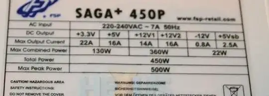

Here is what I mean, this is the specification of a random pc psu
The 12v secs are:
  • 12v1 35A
  • 12v2 35A
The total is 12v * 70A = 840W but as you can see the manufactures allows only 648 combined.
Here is another example
The Max specs for:
  • 5v/3v are 130W
  • 12v1/12v2 are 360W
  • -12v/+5v (vsb) are 22W
If you add these you get 512W But the watts given for all of the above combined is just 450W, even the allowed peak consumption is lower than that to just 500W.
