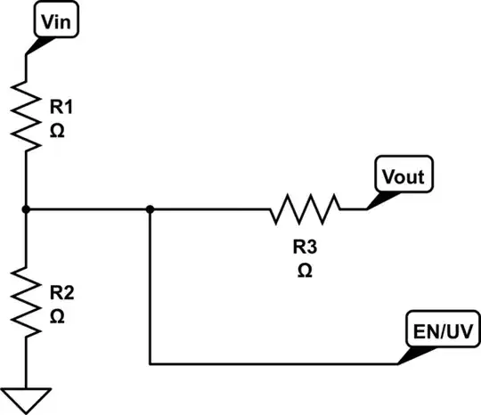

Given the additional information that it is an LT8610, there looks like something that can be done.
The EN/UV input has a 1.0V +/-6% threshold and it has almost no (+/-20nA) bias current. That's with the input rising, it's 40mV less typically with the input falling.
You already have a voltage divider on the input. All you need is a resistor from Vout to EN/UV.
When the UV input is RISING, \$V_{OUT} = 0\$ and thus it will trigger at \$V_{IN}\$ =\$ 1.0V \cdot \$\$(R1 + R2 || R3) \over (R2 ||R3)\$
It is easy\$^{TM}\$ to show that the hysteresis: is \$0.04V\cdot\$ \$R1\over R1||R2||R3\$ + \$V_X \cdot( \$ \$ R1 \over R3\$), where \$V_X \$is the output voltage.
Spehro Pefhany
  • 376,485
  • 842
  • Spehro, this is the exact answer. Thank you very much. Just involves solving the system of equations from KCL. TI has an excellent app note ( http://www.ti.com/lit/an/slva373/slva373.pdf ) which details a similar procedure. The only issue left is what to do with a slowly-decaying Vout as would occur with very light load. The output caps would discharge slowly, violating the Vout=0V assumption on the equations. I'm well on my way to polishing this issue into a solution, thanks to you. – smoothVTer Feb 19 '14 at 21:18
