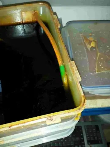

I have done much the same as this with a DS18B20 sensor, only I used it in a home made etching tank (heating element made with ceramic tiles and nichrome wire, old laptop supply and MOSFET with PWM from PIC16F690 using PID for control and simple display with LCD. It's been sitting in ferric chloride for over two years now and is still working fine.
Anyway, all I did was use a length of some clear PVC tubing (kind you get for a fishtank) and fed the sensor (with wires attached) to about an inch from the end. Then I added some clear silicone sealant to coat the sensor a bit for any expansion, and after that mixed some epoxy up and liberally filled the end of the tube with it until it had filled a fair bit past both sides of the sensor. I then added some heatshrink to the end of the tube and put a bit more epoxy in the small gap (this is probably overkill for the terrarium purposes though)
Anyway, it worked perfectly for me in a very hostile environment, so I would bet on it working for the terrarium.
A couple of pics to give a vague idea (sorry, best I could do as the end is glued to the bottom of the tank, and the tank has not been used regularly for a long time so the solution is old...)

  • +1 for simplicity - I'm way too accustomed to using glass pill bottles for deep water submersion, so this totally evaded me. – Anindo Ghosh Jan 13 '14 at 14:46
  • My first try will probably be a length of fishtank hose (8mm diameter). Put the sensor inside and seal with silicone. Do I need epoxy, if I use enough silicon? – Vorac Jan 13 '14 at 14:57
  • I'd say yes, and heatshrink to cap the end too if possible (forgot to mention that, adding it now) If no epoxy then at least something similar. – Oli Glaser Jan 13 '14 at 15:10
  • @Anindo - it's just that I'd already done it that way and it worked nicely (I learnt about any humidity/moisture combined with a potential and also thermal expansion the hard way - amazing how quickly the legs on a TO-92 will disappear as soon as moisture gets to them :-) ) I think a glass pill bottle filled with epoxy seems very similar (as long as the wires are taken care of too) – Oli Glaser Jan 13 '14 at 15:25
  • @OliGlaser My application has a wide range of heat and cold, plus exposure to sunlight, and the pressure of up to 10 meters of water. PVC cracks in about 2 weeks under those conditions. However, for OP's requirement, your method is more than enough. – Anindo Ghosh Jan 13 '14 at 15:28
