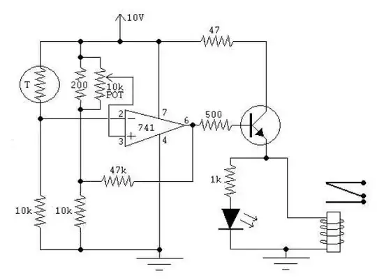

You can build this with a very simple op-amp comparator circuit:
This uses a thermistor as the temperature sensor, and a potentiometer as the thermostat setting. You then just need to hook up your heater to the relay's switch contacts.
You'll just need to calibrate your pot by testing the water temp with a thermometer in different positions of the pot.
The parts should cost no more than around €11/£10/$18. You can power it with an AC adaptor (might be a good idea to add a 470uF capacitor across the supply as well. You can then use the rest of your budget for the heater.

    You'll want some hysteresis on that comparator or your relay will chatter at the setpoint. This is an excellent solution though. It's cheap, it's effective and it works. – akohlsmith Feb 01 '11 at 14:39
    thanks for the answer. How would I design that hysteresis (it should be more than 2 C)? – Tarscher Feb 01 '11 at 16:10
  • I think you'll need to add a schmitt trigger to it, which will basically set the 'on' threshold lower than the 'off' threshold. – BG100 Feb 01 '11 at 16:18
  • I'm pretty sure the way to do that is to add a resistor between the output of the op amp and the non-inverting input. I'm not sure of the value of the resistor though, it might be a good idea to use a variable resistor here so you can adjust the difference between the on and off thresholds. – BG100 Feb 01 '11 at 16:49

About applying hysteresis in the OP-AMP case you can add a feedback resistor from OP-amp output to the (+) input.
Increase the 47k for less hysteresis feedback.
The original circuit benefits from a better use of the 10K potentiometer. If instead connected in parralell with a resitance similar to that of the PT100 at its highest operating resistance the granularity and useful range of the potentiometer is greatly extended. Another 10K was added in series as well.
