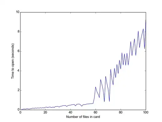

I'm working on a data logger application using a MSP430F5529 running at 2 MHz and a SD card using FatFs. The SPI interface is already running at maximum frequency.
However I am seeing very erratic performance: even with an empty SD card, file creation times start getting slower, to the point that having 100 files in the card sometimes takes almost 10 seconds. In this plot it becomes visible that:
I tried with a few different SD cards to the same results. What to do besides increasing frequency?

You are using _FS_TINY. From the documentation:
The disadvantage of the tiny buffer configuration is: the FAT data cached in the sector buffer will be lost by file data transfer and it must be reloaded at every cluster boundary.
So your micro is spending a lot of time reloading FAT information instead of cacheing it.
If you can spare the memory, try the _FS_TINY=0 configuration.
