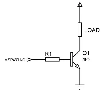

Your circuit will only work as a low side switch, meaning that it should be connected to the ground side of the load like
Low side NPN switch

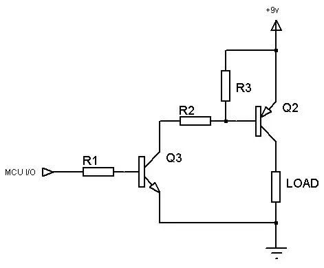

If I understand correct you want to make a high side switch (connected to the Vcc side of the load). In that case you'll need a PNP used as
High side PNP using NPN translator
(I made the schematic for a similar question so don't mind the 9V supply, it's the same for 5V)
Please read my reply to Arduino, NPN and common cathode RGBs.

    Can I know what is the point of R3 ? – xmen Feb 22 '15 at 09:50
    @xmenW.K. The collector-base capacitance of Q2 can slow switching when Q3 turns off, so R3 can speed up turn off by pulling the base high. The other reason is to bleed off leakage currents of Q2 that may turn the transistor on. It also shunts noise signals that may also turn the transistor on. – alexan_e Feb 22 '15 at 11:37
