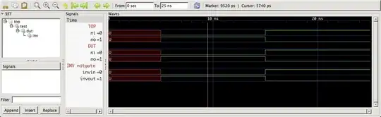

I don't have a Xilinx ISE license running anywhere but do have a recent ghdl and gtkwave. After insuring analysis of notgate before not_gate and because ghdl doesn't have an interactive shell for simulation I added a testbench providing stimulus:

I saved your notgate, not_gate and config1 design units and appended the above test bench test all to notgate.vhd. And:
ghdl -a notgate.vhdl
ghdl -e config2
ghdl -r config2 --wave=config2.ghw
gave:
config2 ghw waveform dump for test bench
This tells us two things. 1) Your configuration works and 2) there are alternative tools where configuration works properly.
It tells us a third thing too, that you might need to do without configuration in the particular synthesis environment, but you can separate learning VHDL from a particular synthesis environment.
This was done with a gcc-4.8.2 version of ghdl (ghdl-0.31dev) running on OS X 10.9.1 and using gtkwave 3.3.53 (the OS X app version).
