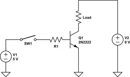

What you're doing is "high-side switching". The voltage across the base and ground is much lower than the voltage across collector and ground, so that's what you're switching, minus the drop across the transistor. Since the voltage drop across base and emitter (VBE) is typically 0.6 at saturation, you're seeing the voltage from the Arduino (approximately 5V) minus this drop.
Since you're using a N-type device, you want to perform "low-side switching". The emitter is tied to ground, and the voltage is measured between the high supply and the collector.
R1 should be sized so that enough current is allowed through to saturate the transistor without allowing VBE to cause the supply voltage to sag too much.

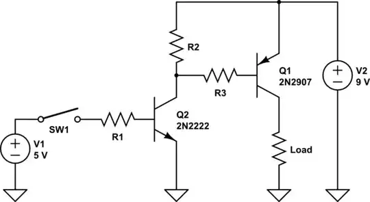

If you still want to perform high-side switching of a higher voltage then you should switch to a P-type device instead and put a N-type device in front of it to switch it.

  • Thank you Ignacio. I used Peters suggestion and am getting the correct reading in my multimeter now. Appreciate your help! – Marko Jan 01 '14 at 00:54
    Regarding the high side switch PNP configuration you show and the fact that the base is driven from an Arduino with either 0v or 5v, how do you expect this to work? I see a circuit that will never turn off, the Vbe will either be 4v or 9v. – alexan_e Jan 01 '14 at 10:01
  • @alexan_e: You're right, I don't know what I was thinking. – Ignacio Vazquez-Abrams Jan 02 '14 at 23:38
The circuit you describe is an emitter follower - the emitter voltage follows the base voltage and is always about 0.7 volts negative of the base. The transistor doesn't care where you think "ground" is, its operation only depends on the voltages between its pins.
If you ground the emitter, and put your load between the collector and the positive supply, you will be able to get very close to the supply voltage across the load when the Arduino output is high. You should have a resistor of 1K or so between the Arduino output pin and the transitor base, to limit base current and loading of the Arduino output pin.
