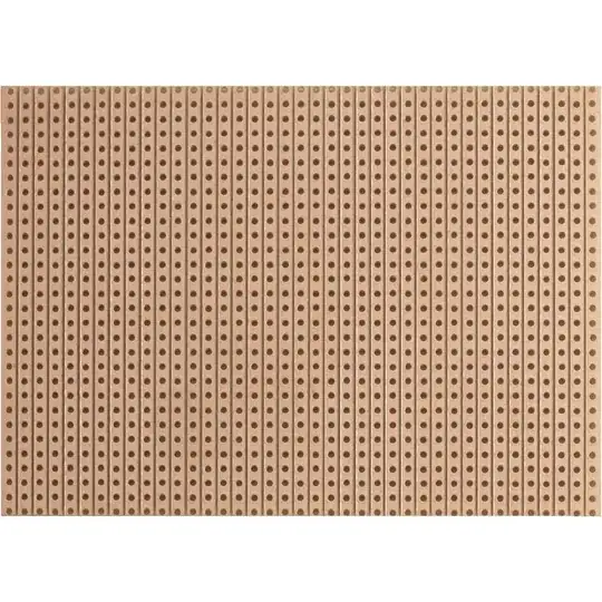

Since I've started electronics I'm using this kind of board for permanent projects:

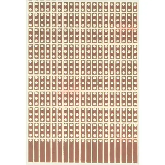

But sometimes it's a bit annoying, especially when I need a line going from the top to bottom of the board. I've seen this kind of board:
My question is, how can I cut the strips?
By cutting the strip I don't mean cutting the board itself, just the copper strip. I've tried with a precision knife but I'm not sure about the method, the blade gets damaged really quickly and it's really hard to cut the copper.

  • Also, there are 3-track boards with readily available long tracks alongside for GND and Vcc. – Roman Susi Dec 26 '13 at 18:57

There are specific tools that are designed to cut holes in this material, which is either called "stripboard" or "veroboard". These tools are basically a drill bit in a moulded handle made of plastic or wood and look something like this:
Stripboard track cutter
(photo from here)
Because it is basically a drill bit you could use any high speed steel drill bit. There are some good instruction at Instructables that show how to cut neat holes. However if you plan on using stripboard often then it is worth buying a tool with a handle, they are quite inexpensive.

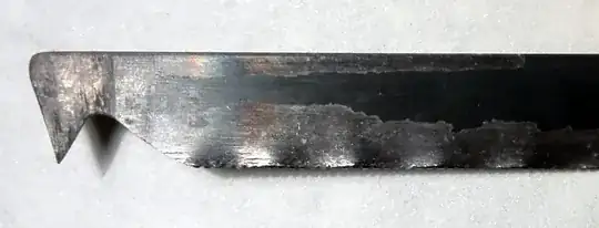

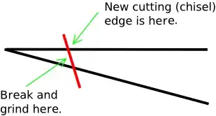

I use a variant of the knife blade approach that others have described. Rather than using the sharp edge of the blade, though, I reform it into a chisel, which very cleanly cuts through the copper cladding leaving a channel the width of the blade.
Taking a disposable knife (X-Acto in the USA; not sure how global they are) of this general form:
X-Acto Blade
With a small pair of pliers I snap the tip off a few millimeters from the end (protect your eyes!). Then with a small whetstone I grind the broken face so that the metal forms a slightly less than 90-deg angle with the top edge of the blade. I also hone the top edge, so that there is a very clean edge where the new face and the top meet. You could also do this on a power grinder or sander with a very fine grit wheel, but it only takes a couple of minutes to do it by hand. You may also want to round off the remaining sharp edge of the blade for improved safety, or keep it for other modes of use.
Chisel
Now, turning the blade "upside down", so that what was the top edge is now held almost parallel to the surface to be cut, you chisel through the copper just as an engraver would do when making a printing plate. In fact, if you have access to real engraver's chisels, that might be even better. I find it easy to make very clean cuts. The copper just peels up in a nice curl with smooth edges. You might want to experiment with the angles of the cutting edge, both the angle in the plane of the blade and tilting the new face a few degrees from perpendicular to the plane of the blade. Don't make the new angle too acute or the tool will tend to dig into the work too much. Just a little less than 90-deg should be fine. If it doesn't work just right the first time, modify it a little and try again. Also try holding it at slightly different angles to the circuit board. If the edge gets dull, just a few strokes on the whetstone will fix it.

  • A video of this would be nice. And there are chisel blades for x-acto knives as well. – Passerby Feb 02 '16 at 03:52
  • A video is a great idea, but I don't know when I might get enough time and inspiration to make one. I'll keep it in mind. I know there are wood carving chisel blades for X-Acto knives, but I'm not sure how well they would work in this application. Modifying regular blades is really quite easy (and cheap), though. – user98732 Feb 02 '16 at 06:55
  • Seems like this could also be a useful tool for cutting PCB traces to make circuit modifications. – pericynthion Apr 12 '19 at 05:43
  • Great idea. With a "blunt" angle like this I would call it a scraper rather than a chisel, but most important thing that it works :) – Gene Pavlovsky Oct 13 '20 at 21:52
  • One thing to note: When grinding the blade to shape with any sort of power grinder, only a very light touch should be used, and the blade should be cooled if it gets hot. If the steel changes color to blue, you've ruined the temper and the blade will get dull very quickly. – Gene Pavlovsky Oct 15 '20 at 06:48
  • Another similar option would be to use an HSS parting blade or tool (used on metalworking lathes to cut off the workpiece, or to make grooves), they are available in different widths, and have a very similar geometry to the one described above. Being made of HSS, the geometry can be fine-tuned on a grinder without too much worry about overheating. Honing is most done on diamond stones (or just sandpaper). Then all you need is make some comfortable holder for the cutter. The cutter will last for a very long time. – Gene Pavlovsky Oct 15 '20 at 07:04
  • This is a great technique. I was amazed how cleanly and easily the chisel edge was able to slice through the copper track, even in a single pass. The width of the resulting gap is perfect and easily enough to help prevent accidental solder bridges. – Jonathan Holvey Jan 26 '21 at 08:58
  • There are 2mm chisels that can define a piece of copper for lifting away. Homemade or commercial – Whit3rd Jun 14 '21 at 05:19
