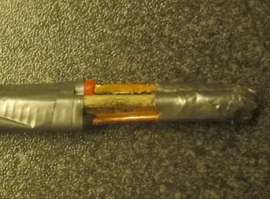

However, in practice the soil resistance turned out to be subject to a very large drift. Almost immediately after turning on the device, the measured soil resistance started dropping. (This also happens if you stick a multimeter in the plant.) After a few days of measurement, I could find no usable connection between the measurements and the moisture level. Removing the probe and inspecting it revealed considerable tarnish on the anode. To me, this indicates that some sort of chemical reaction is taking place (electrolysis?). A multimeter measures a voltage differential of a few tens of millivolts: I have turned my plant into a battery!
Oxidized anode

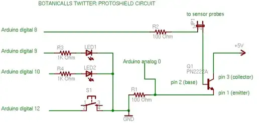

Here's how botanicalls does it.
Toby Jaffey
  • 28,796
  • 96
  • 150
  • Am I correct in assuming the 9, 10 and 12 pins are used for other things? They don't seem to affect the sensor circuit. – drxzcl Jan 26 '11 at 21:24
  • Yes, it looks like 9 & 10 are just controlling LEDs and 12 is a switch – Toby Jaffey Jan 26 '11 at 21:38
    Let's see if i get this. I would drive 8 high, establishing a (small) current through the probe. This current is amplified by the BJT and I would measure the voltage drop of this current over a known resistor of 100 Ohm. What would this buy me over the voltage divider design? – drxzcl Jan 27 '11 at 01:05
  • Thanks for pointing me to Botanicalls! I have examined their schematics and code and I have made some interesting discoveries, aside the difference in measuring circuits above. They use galvanized steel electrodes that are only energized during measurement (no delay at all, not even a ms) and they still have problems with degradation due to electrolysis. They also keep a moving average of the moisture sensor readings, by default 10 samples over 2 minutes. I'll experiment a bit and report back. – drxzcl Jan 28 '11 at 09:22
