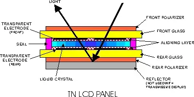

LCD panel
The ITO conductors and the individual "pixels" can be seen by looking through an LCD panel into polarized light. For instance, the reflection of the daytime sky on a glass window or automobile windshield serves nicely: The reflected light is polarized, so by rotating the LCD around, at certain angles the pixels (and to an extent the ITO traces) will block this light through cross-polarization.
For the second question, the simplest parallel is to consider double-sided PCBs. The copper traces on such PCBs are etched on both sides of the substrate, thus a crisscross matrix of connections can be achieved without any two traces intersecting with each other. The same rationale applies to transparent ITO conductors in an LCD - to over-simplify, consider all horizontal traces to be on the upper layer of glass, and all vertical traces to be on the lower layer.
In many modern LCD technologies, the traces can actually pass not just between the pixels, but also beneath them: The conductor layer is distinct from the liquid crystal layer. The liquid crystal cells themselves are activated not by electricity passing directly through them, but by the effect of an electric field they are exposed to. Thus the ITO conductors simply need to be above and below each pixel, and the liquid crystals align according to the direction of the field.
This crystal alignment gives rise to the polarization of the light passing through. As a fundamental principle of optics, if light polarized in one direction is passed through a polarizer aligned at right angles to it, the light gets absorbed - thus giving rise to the opaque pixels. Change the electric field, and the polarization changes, the opacity abates.
