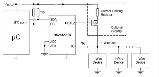

Up until now I have powered the DS1822. I would like to implement the 'Strong Pull-Up' circuit defined in the datasheet above as specified in the circuit in 'POWERING THE DS1822'. The strong pull up circuit calls for a MOSFET driven by a second digital pin (SPU) on the MCU that can pull the 1-wire bus straight to the 3.3v rail during operations that require additional current and a sustained voltage level.
The question I have specifically surrounds the possibility of a short circuit. If I implement the circuit as shown in the diagram, it would seem that as long as my digital pin (DQ) is set to an input while the second digital pin (SPU) enables the 'Strong Pull-Up', then a short circuit would not occur.
However, should my digital pin (DQ) be set to an output and driven low while the second digital pin (SPU) has enabled the 'Strong Pull-Up', it seems that this would create a short circuit through the DQ pin.
As I am only surface level versed in circuits, I'm seeking the expertise of this group to confirm that this is indeed a danger. Additionally, I'd like to understand what could be done to protect the input pin under this scenario. Would the addition of a resistor between the 3.3V rail and the MOSFET ensure that the level of current sunk by the digital pin stays within the MCUs' parameters enough?

  • The intention of the 'Strong Pull Up' is that the master only turns it on during those times that when nothing (including the master) is pulling the line low. In short the MCU must release the 'Strong Pull Up' when the line could be pulled low. – Spoon Dec 20 '13 at 09:02
As shown here, there are two things that can be done.
The Strong Pullup through the Mosfet, should have a appropriately sized Current Limiting Resistor, allowing the tens of milliamps required. If those tens of milliamps are more than your ic's pin can sink, then a secondary in-line resistor (Rt) can be used on the line, for protection.
Best source of information regarding one-wire is of course, Maxim-Dallas's app notes.
